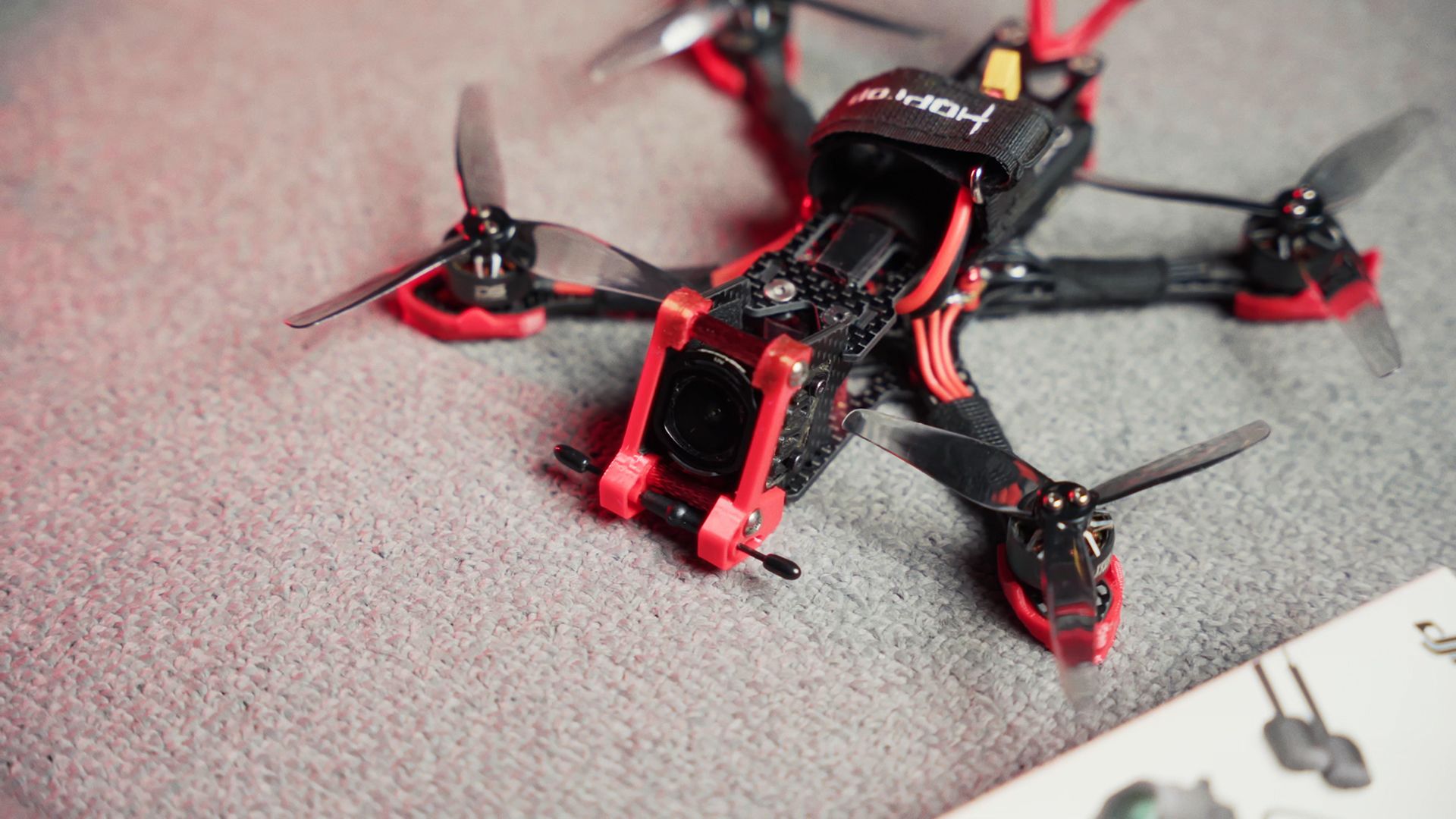

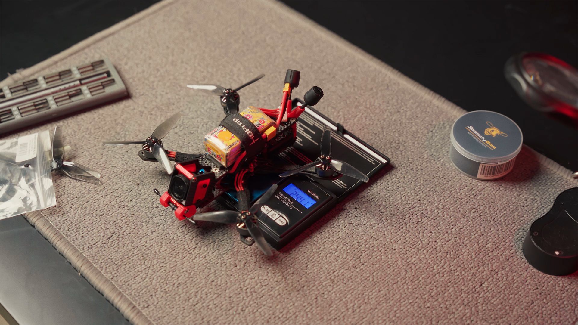

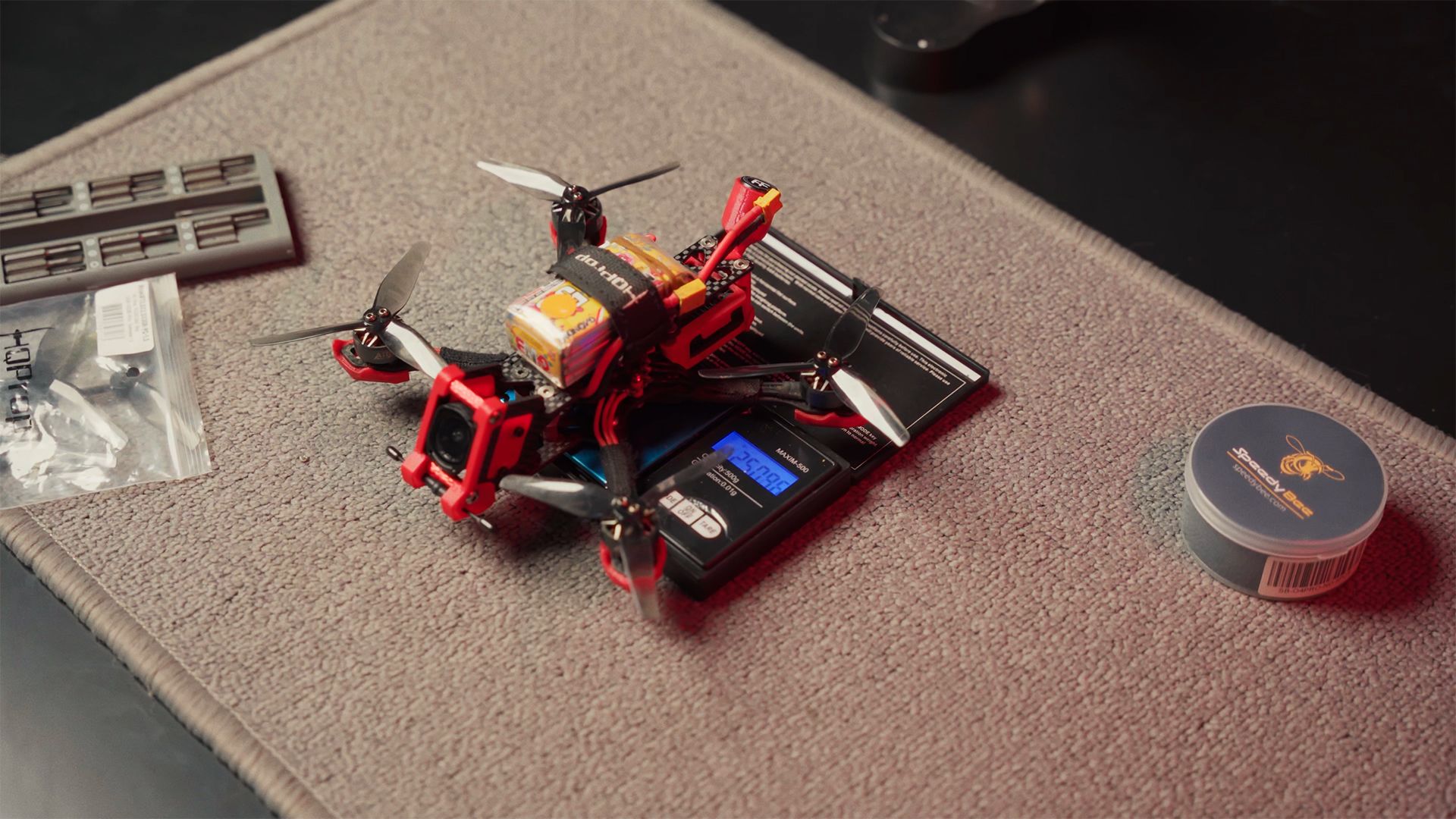

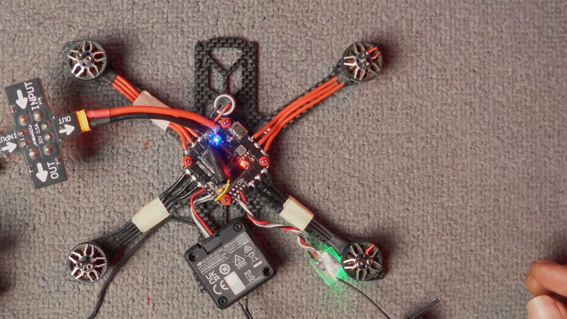

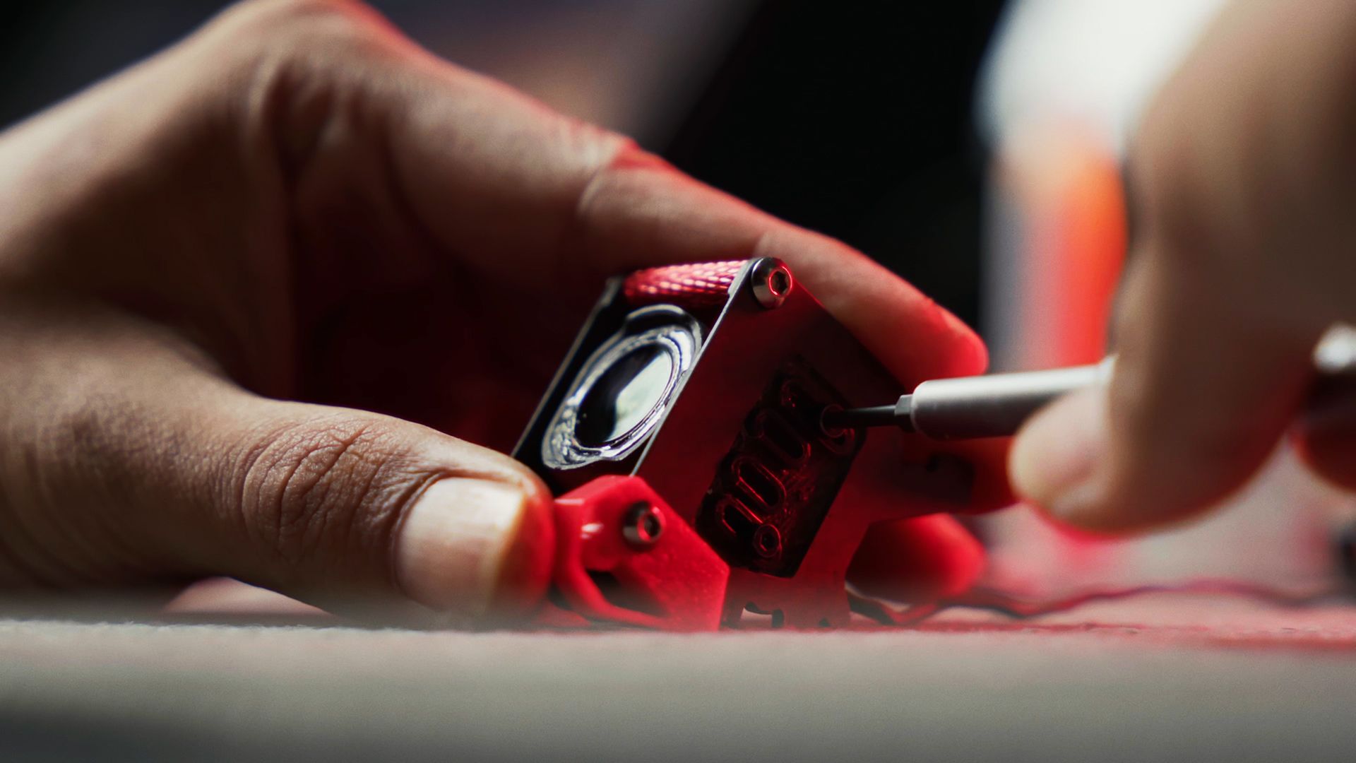

dkzfpv Posté(e) Janvier 3 Signaler Posté(e) Janvier 3 Topic Attachments This is my first time posting here. The hunt began when I'm not happy with my previous 3.5" frame (Flyfish VX3.5) because of the props in view and really holding my mentality to full send a quad because I'm afraid of breaking something from the frame and have to wait for weeks just to get the spare parts to arrived. I Found JeNo 3.5" frame - and everything changed completely... Spend nearly 6 months just to learn CAD & really understanding how to cut the frame - but in the end, this frame allowed me to customized it the way I needed it to be. I named it El Diablo - based on MotoGP racer Fabio Quartararo (to complete the "French" reference) Printables Page: https://www.printables.com/model/1538007-jeno-35-dkz-version Youtube (Build Processed & Flight Sample): Moved the back stand off by 2mm because in the original file it's interfering with the middle plate and arms. Redesign all the 3D TPU Pack to better follows the frame Using only 3mm Thick arms and 2mm on all other parts. At first, I didn't have much expectation when it comes to sustainability - but despite my horrible flying skill, I've only break 2 arms so far. (more to come surely) but this build really checked all the boxes that I need, so I thought I shared it here. There's 3 different set up that I come up with GNB 650mAh Battery and FULLY WATERPROOFED: The Base Set Up: 244.17gr AUW The NaVi Set Up: 248.74gr AUW El Diablo Set Up: 250.96gr AUW (My preference) I Do need to mention to that I have an external BEC on my AIO - because it was dead You can also found this build on Youtube, will be appreciated if you guys enjoyed it!! Now I can't helped myself to build the 5" version POIDS : 179 grammes Liste des composants Frame JeNo 3.5 (DKZ Version) 34 € FC JHEMCU GHF722 HD AIO 38 € ESCs 4 x JHEMCU GHF722 HD AIO 152 € Moteurs 4 x Deepspace Aether 1505 4000KV 48 € Jeu d'hélices 5 x HQProp T3.5x2.5x3 10 € Caméra FPV DJI O4 Pro 195 € Émetteur vidéo DJI O4 Pro Antenne vTx Flyfish BiPolar (45mm) 9 € Récepteur radio Happymodel EP1 Dual TCXO 10 € LiPo GNB 650mAh HV 4S 13 € Prix total : 509 € 7
