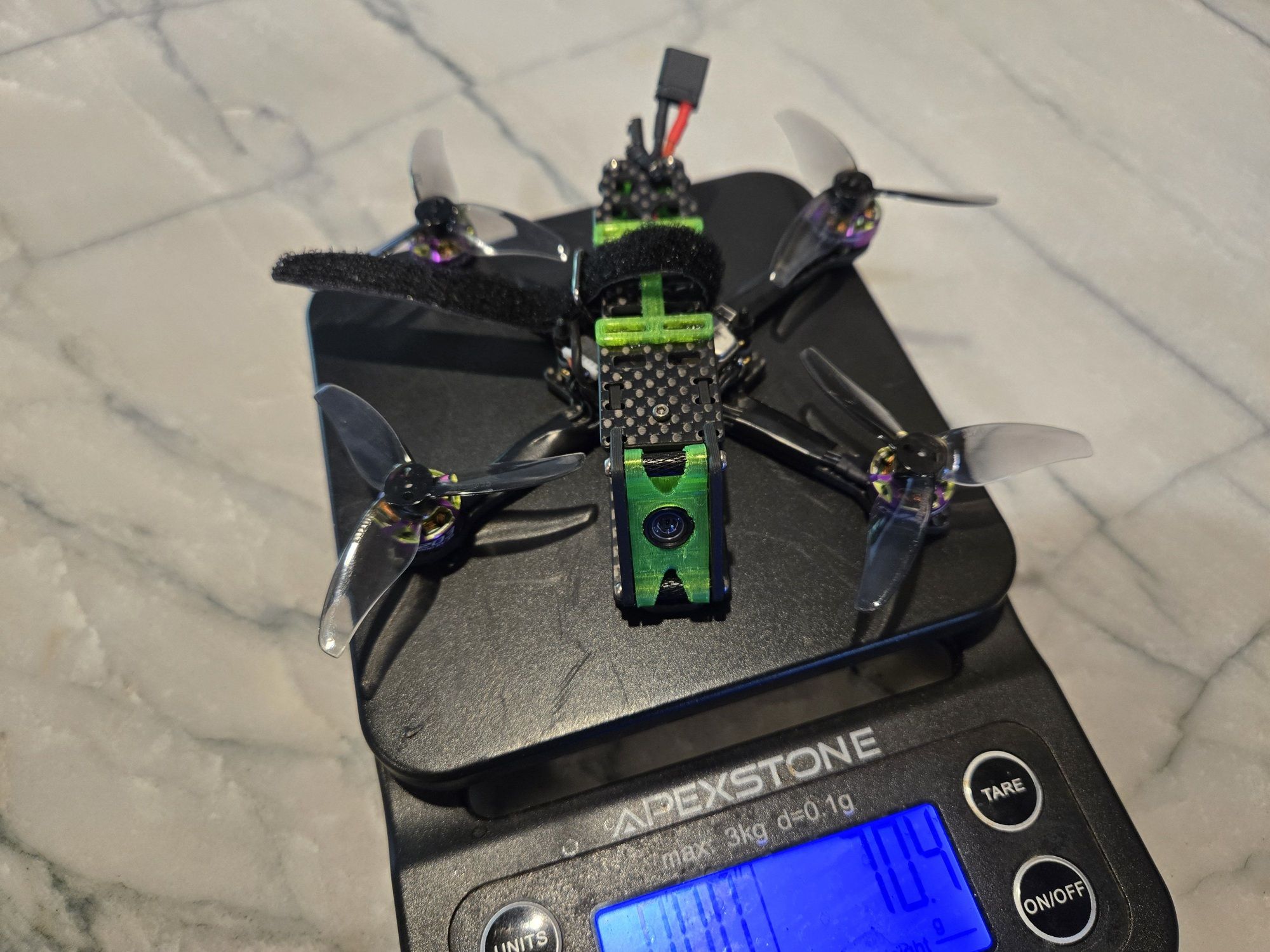

Apologies.  I also made a Jeno 3" at the same time.  I'm getting a little mixed up.  The Jeno Pocket has a 3mm bottom plate and GF2520 props.
il y a 19 minutes, Jeremy257 a dit :
